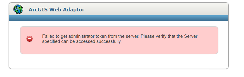

Failed to get administrator token from the server. Please verify that the specified server can be successfully accessed

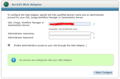

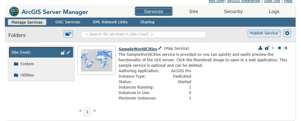

I'm having an immense issues trying to configure my server and portal web adaptors. I'm logging in using the correct admin username and password, my servers are setup properly and I can connect no problem in ArcGIS Manager on each, but for some reason, I keep receiving this error no matter what I do. I've worked through different scenarios but nothing seems to work.
JoshuaClanton
The issue was completely in-house. The web server was moved to a DMZ network and I'm not 100% familiar with our network/firewall rules. Rules had to be set in place to allow traffic between servers. No traffic was allowed, therefore, web adaptor configurations failed immediately. My Enterprise environment is working fine now with no issues.

Ensure that you are using the port number while defining the Server URL.
e.g., For the GIS Server URL, are you using "https://<Server.Domain>:6443" ?
Also ensure that you are using credentials of an ArcGIS Server Administrator (e.g. siteadmin).
Allow the required ports through firewall, if not already done.

Yes, I'm using that URL format along with the 6443 port number and specifying the server domain. The account login is used specifically as the server admin so I don't think that is the issue
The web server is already placed on a DMZ network and has all the necessary security certifications within our organization so that should be good to go. I'm very curious because it fails right away without hardly any load time.

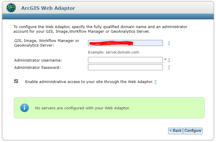

Hey there @JoshuaClanton, for newer versions of ArcGIS Enterprise you only need to enter the machine host, no need to include the port (not sure if you did that in your screenshot but including the port will cause it to fail right quick.)

Hi @JonEmch , I came cross your comments while trying to troubleshoot the exact same problem titled in this thread on a new server. Leaving that aside. My question is, currently my prod enterprise server's WA was already configured with the port number, but if I remove the port, it would give the the same warning as titled in this thread. Any idea what may have been misconfigured?

Ah I see, where I got turned around. I thought you federated with the port number in the Web Adaptor configuration screen, that now only accepts the host name. I would leave the port number as is within the configuration.
