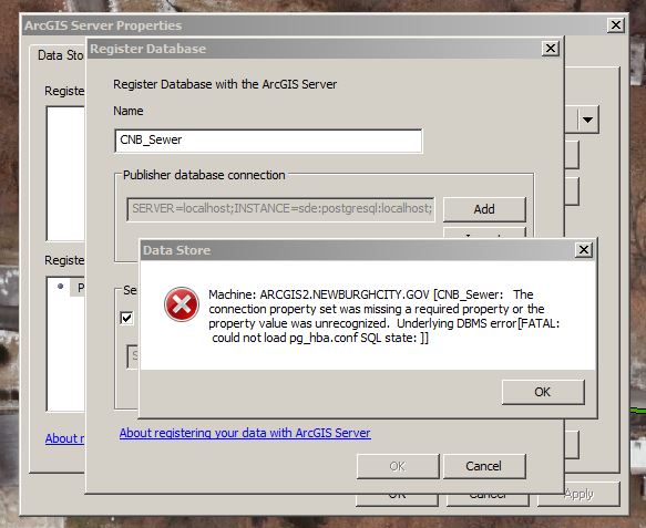

I am using ArcMap 10.3.1 and have downloaded the PostgreSQL 9.3.5 files from MyESRI.com. PostgreSQL is installed locally for testing purposes. I have everything working smoothly and am attempting to publish the data for use on a tablet in the Esri Collector app. In order to do this I have to register the database with ArcGIS Server.
I edited the pg_hba.conf to allow remote connections, since ArcServer is installed on another machine. When I attempt to register the database I get he error in the following screenshot. I have attempted an exhaustive Google sreach for a resolution with no success.

I really like the idea of trying to connect with PGADMINIII. The error message indicates something's up with PG_HBA.conf that's rendered it unusable. If you enable 'show extensions for known file types' in windows explorer, was there a .txt extension slapped on the end of PG_HBA?
Personally, I'd replace PG_HBA.conf with a backup and attempt to connect to the database with a local copy of PGADMINIII (or ArcGIS Desktop), since localhost will be allowed by default.
