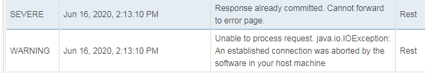

Some of the feature classes were in fact empty. I've since populated them with one or more features but still cannot load into ArcMap. Server logs show two errors:
I've created a case for this issue but if you have any other thoughts or suggestions please let me know.
