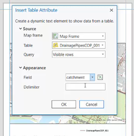

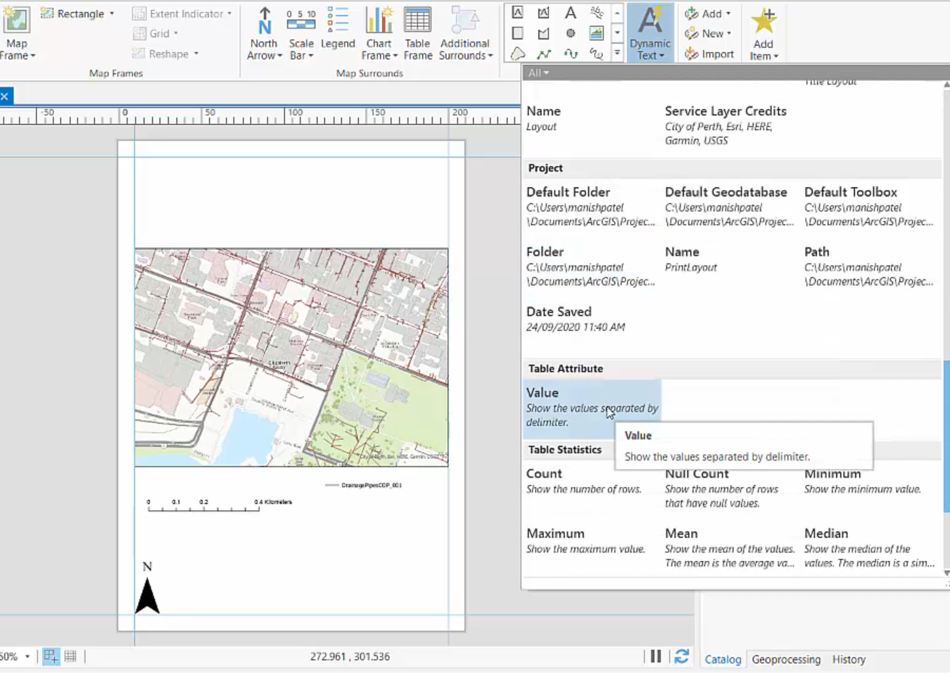

  • The dynamic text element 'Value' is added as below to the layout in ArcGIS Pro.
  • Set the attribute for the dynamic text value element as shown below to show visible rows

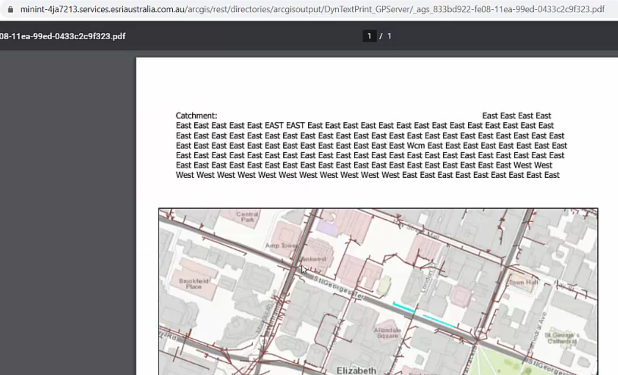

  • In a web application created using the WAB configured the print service to use the layout created.
  • The pdf print document shows the dynamic text with all the values.

Hey Everyone,
Turns out that the way it is supposed to work is not what I was looking for. It will work on the features that are visible in the map frame but not on the selected features on the map. The alternative would be to use a report along with layout as an option.

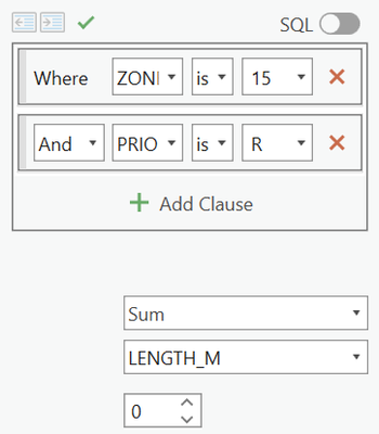

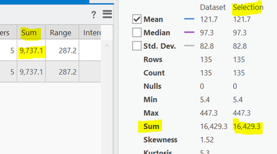

Looking for some help with a dynamic text query that should display the length of a route based on its priority. I'm not understanding why the number in my layout isn't matching what can be seen in the Statistics and Data Engineering panes:
I believe the dynamic text is displaying the sum of priorities R (9,737) and W (825)
