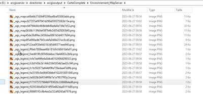

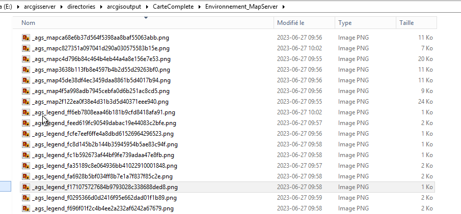

I have noticed that some of my dynamic MapServices published on Enterprise 10.6.1 are automatically caching the map images and legend symbols in the arcgisoutput directory of the service.
For instance, _ags_map2f122ea0f38e4d31b3d5d40371eee940.png is an example of a cached map image and _ags_legend_f171075727684b9793028c338688ded8.png is an example of cached legend symbol.
The cache parameter of the service is disabled but a lot of png are cached in that directory each time someone use the map service in a map.
In the web app builder map, I can see in the developer tools that the requests are made to the cached png instead of the dynamic map service.
Why is this happening? How can I stop that?
