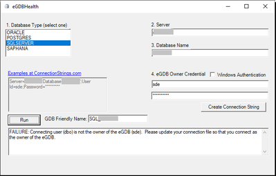

I'm trying to run Egdbhealth against a SQL Server db we've set up to get a baseline before we start building it out more and evaluate migrating from Oracle. I'm admittedly new to SQL Server so this may be an easy question. The error I'm getting is:
Connecting user (dbo) is not the owner of the eGDB (sde). Please update your connection file so that you connect as the owner of the eGDB.
This is the way it looks from the interface:
I'm trying to connect using the sde user, not dbo, so I don't understand why the error message seems to be reversed. I've confirmed that the sde user has db_owner role membership on the database.
Thanks for your help.
Chris

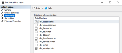

I just checked mine and do not have any of the DB role memberships checked.
Do you happen to have the SDE user in the "SYSADMIN" fixed server role? (at the instance login level)

I would remove the db_owner role from the SDE user on that specific geodatabase and re-test.
I think that permission is only needed to upgrade the enterprise geodatabase: https://pro.arcgis.com/en/pro-app/latest/help/data/geodatabases/manage-sql-server/privileges-sqlserv...
--- George T.

Hi George and thanks for your reply. I tried doing that and got the same result, unfortunately.

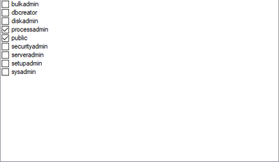

These are the current memberships for the sde user in case something else is off:
Thanks again.
Chris
