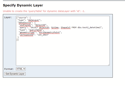

However, if do not use SELECT *, instead, if I include spatial column name in my select statement, it will return an error:
Do you have any idea what is going on?
