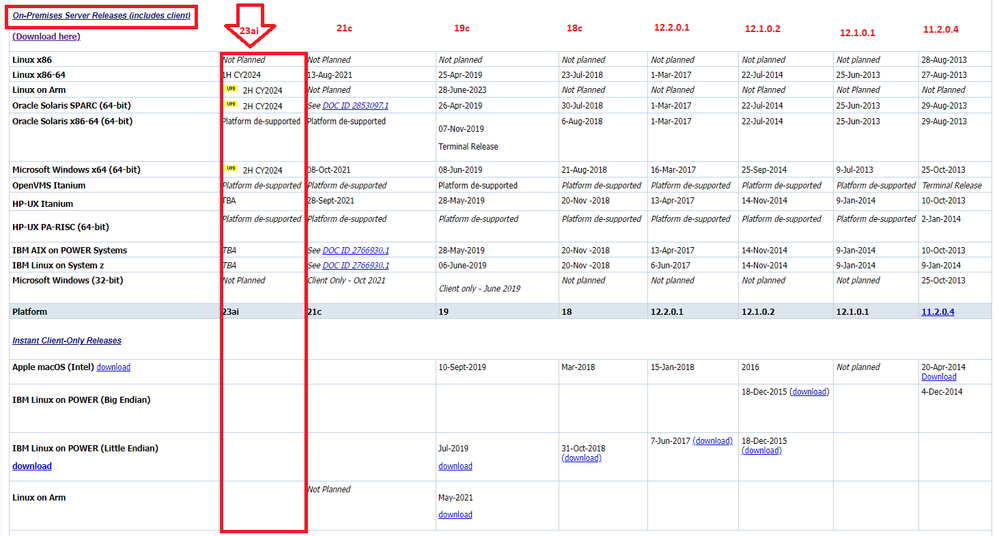

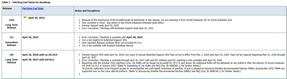

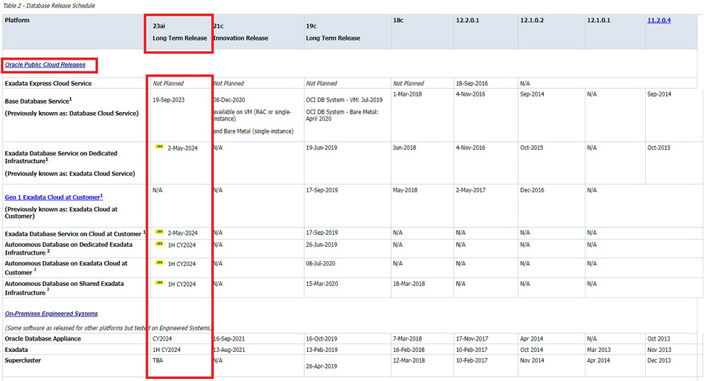

MarceloMarques
@MaddieMooreDEQ
- Oracle 19c is still a long-term Oracle Database Release supported by Oracle and Oracle does provides patches.
- ArcGIS Pro 3.2 and ArcGIS Enterprise 11.2 support Oracle 19c.
ArcGIS 11.2 and ArcGIS Pro 3.2 requirements for Oracle—ArcGIS Enterprise | Documentation for ArcGIS ...
- Oracle 23 is the next long-term Oracle Database Release.
- Oracle 23c On-Premises for Linux / Windows has not been released by Oracle yet.
- Oracle 23c Release was renamed to Oracle 23ai because of the importance of the breakthrough AI technology in this release.
- Oracle 23ai is only available in the Oracle Cloud.
- Oracle has not announced when Oracle 23ai On-Premises will be released.
- ArcGIS will support Oracle 23ai On-Premises and Oracle 23ai in the Oracle Cloud in a future ArcGIS release probably only after the Oracle 23ai On-Premises is released.
MOS: My Oracle Support - support.oracle.com
Release Schedule of Current Database Releases (Doc ID 742060.1)
2H CY2024 = Date falls within the 2nd half of Calendar Year. Jul-Dec 2024.
I hope this clarifies.

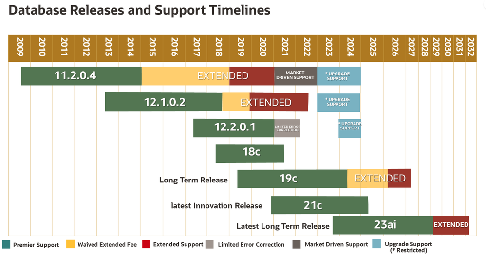

Bud
Esteemed Contributor
Out of curiosity:
For organizations who might be doing a GIS upgrade project in the next 6-9 months:
If Oracle 23ai on-prem hasn't been released at the time of the upgrade, or if ArcGIS Enterprise doesn't support 23ai at the time of the upgrade, is there a risk that the new ArcGIS Enterprise implementation would be forced to use 19c, which will only be supported until 2026?
For organizations who only have resources to upgrade their GIS every 5-6 years, would they be caught in an awkward spot where they’re using 19c, which would be unsupported shortly after implementation?
This isn't my area of expertise.
MarceloMarques
@Bud - Oracle might decide to extend the support of 19c once Oracle is taking a long time to release 23ai On-Premises, this has happened with other versions of the Oracle Database in the past, hence Oracle might continue to support the old long-term version for a few more years till all the customers have time to migrate to the new long-term release.
