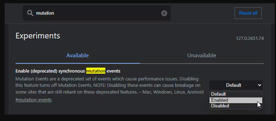

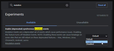

This is certainly a challenging situation. However, I understand that switching browsers across an organization or upgrading the environment to a newer version is not a decision that can be taken lightly. It is also unlikely to be an easy task to accomplish in a short period of time. As an alternative, you could consider leveraging the `MutationEventsEnabled` property as mentioned in the following article, which @RyanUthoff mentioned:
https://support.esri.com/en-us/knowledge-base/impact-of-google-chrome-and-microsoft-edge-127-updates...
For more reference utilize the below:
For Testing:
If the above solution works, it seems that applying this setting through a group policy would be a simpler approach compared to switching browsers or upgrading the environment. This method would minimize disruption and not require any additional effort from end-users.
Furthermore, I can look into finding the steps to deploy this as a Group Policy and share them with you. However, I would strongly recommend reaching out to your IT team for assistance with this process. That said, if you still need further details or clarification, please feel free to let me know, and I will do my best to provide the necessary steps.
