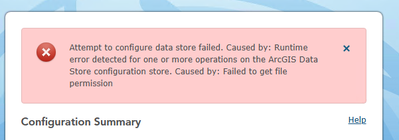

is it possible to configure a Relational and a ObjectStore on a single virtual maschine? or vice versa?
This error message occurs:
For analysis purposes, we have extended the ervice user's rights to an administrator account.
We're working on a Windows Server 2022 datacenter maschine.
Thx and regards
Max

I believe it is possible to install them on the same machine, but it is not recommended as the resource utilization would possibly bring the servers down, see the Note here: https://enterprise.arcgis.com/en/data-store/11.4/install/windows/install-data-store.htm
In this case, it looks like the server is unable to reach the files you've configured for the config store. In this case, the administrative account may not be enough to actually allow the configuration file to be exposed to the server. In this case, you may need to go to the config file and actually add the permissions to the folder using the Properties -> Security which would then give the service account the required permissions.
You may also contact Esri support, as they're more than likely familiar with these situations and could immediately point you to the right area to make these changes, but they may push on the separate servers for the data stores!
