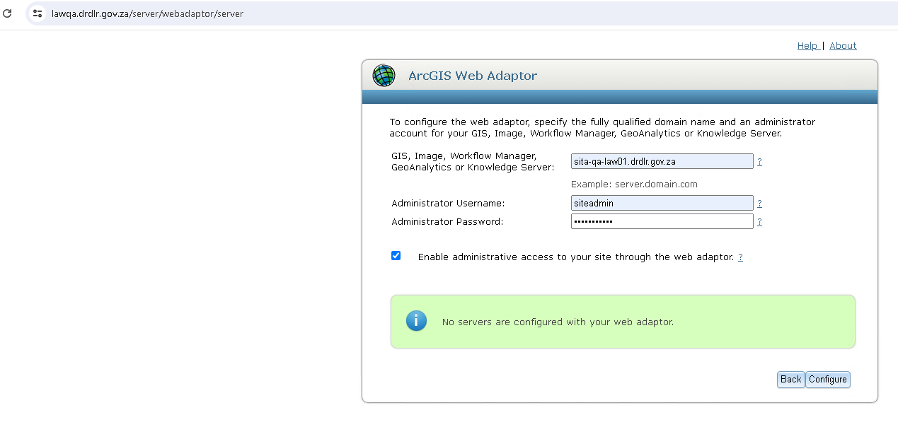

I have upgraded from ArcGIS Server 10.9.1 to 11.3 on our QA server.
After the upgrade I installed the IIS web adaptor for 11.3, with it's dependencies.

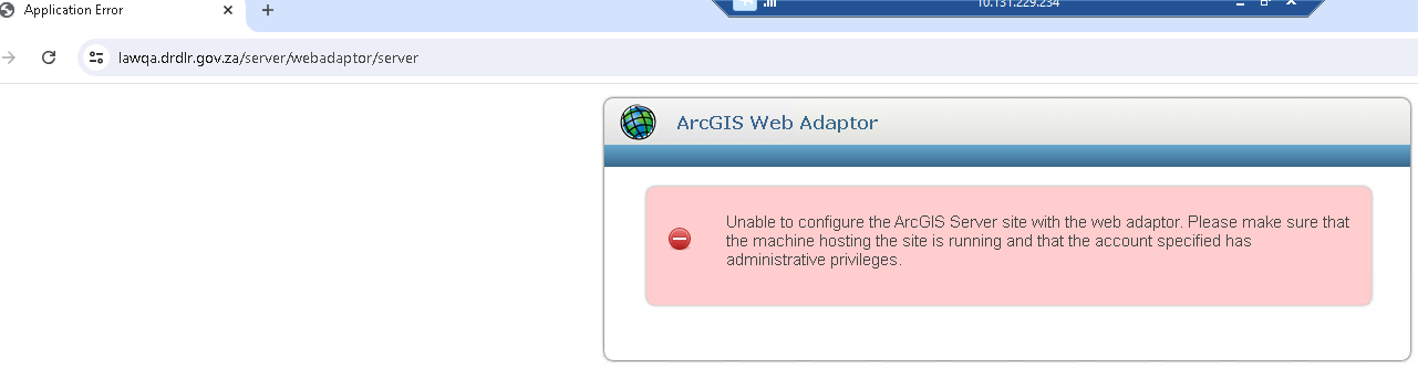

When I want to configure the web adaptor I get the following error message:
Unable to configure the ArcGIS Server site with the web adaptor. Please make sure that the machine hosting the site is running and that the account specified has administrative privileges.

The ArcGIS 11.3 will work with the latest web adaptor, try once entering the same old password in the WebAdaptor 11.3 to add the GIS Server (its sounds crazy but somehow the old user password combination is saved somewhere which the new web adaptor needs).
Thank you so much for posting this. It never would have occurred to me that I would have to enter the previous password, which I had changed over a year ago, but that's what finally worked for me.

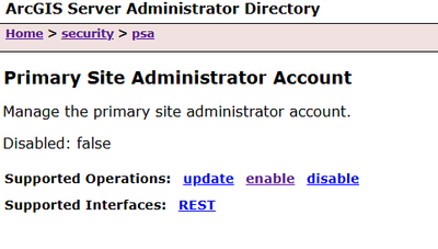

It might help to set the password for the primary site administrator again in
https://<DNS>/arcgis/admin/security/psa/update
Bit late to the party here, but having just experienced this after upgrading from 11.4 to 11.5, our solution was simple. After previous upgrade I had disabled the PSA account. Once I had enabled this, the web adaptor config worked as expected.
