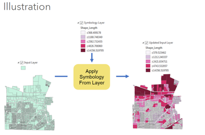

RanaDas
Hi @davedoesgis.,
One possible way is to add both existing and new webmap in ArcGIS Pro an then your Apply Symbology from Layer tool to make the changes.
You can refer this link for more details: Apply Symbology From Layer (Data Management)—ArcGIS Pro | Documentation

RanaDas
Hi @davedoesgis.,
Regards,
Rana

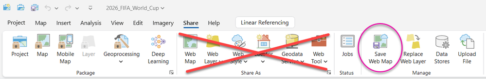

davedoesgis
Excellent, this does what I need. As I mentioned up top, I'd be inclined to use Python, but this will work well for my coworkers in Pro.
Note that the share option to save the map from Pro back to portal is inexplicably not in the context menu, like the share options for everything else in Pro. You can find them by activating the webmap map view and going to the Share ribbon. Once you're there, you wouldn't be insane for thinking it would be in the Share As group, but you'd be wrong... Go to the Manage group and select Save Web Map.
Thanks to a great article from tribalgis.com for explaining this.
The Save Web Map interface looks a lot like the other sharing interfaces. Note that I got a bunch of warnings in the analyze messages about things that were incompatible with Pro. This is odd, because the map came  straight from Pro and I just changed one symbol in my test. The warnings were mostly about attachment sort order in the popup, so this is pretty down in the weeds, but might be important someday.

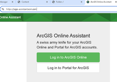

RhettZufelt
MVP Notable Contributor
Not an answer, but letting you know that AGO assistant is available in portal.  It is just a webpage that will let you log into Portal (at least up to 10.9.1, suspect it works with newer versions).
