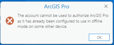

Does anyone have experience with upgrading their portal after switching to named user licenses? We just upgraded from 11.4 to 115. with named users for the first time. Because the licenses are tied to the portal, Pro would be down for the upgrade time. Our first instinct was to have users checkout an offline copy. However, after upgrading, this is the error message users who check out a license got, and we have to manually release the offline licenses:
Taking licenses online is also not recommended by ESRI:

The issue is that users cannot access Pro at all when the portal is offline for names user licensing, as that is where the authorization to use Pro is stored.. Did you use named licensing as well?
