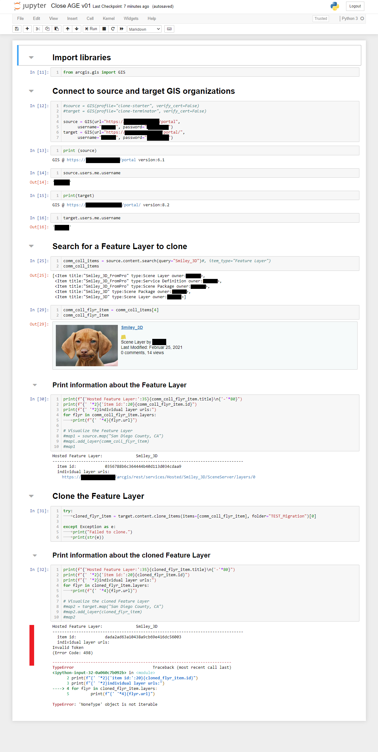

I am trying to migrate/clone layers from one Enterprise installation to another. The cloning seems to work; the specified folder is created and the item is there. However when I try to open it, I get a prompt to log into the source as if the item wasn't cloned but just referenced/linked. The notebook also throws error code 498, but that might be the same issue. What's the problem here? Here's the whole notebook:

Also trying to move a scene throws no token error but as expected it fails, just differently, as well.

Hi @LR2, there is a attribute in the clone_items method called copy_data=False try setting it to True.
Regards
Henry
LR2
Thanks, unfortunately that seems to do nothing, at least the error is the same as above. I followed this instruction video, which does not mention the copy method at all. Perhaps it should be reviewed if the shown methods actually work.
