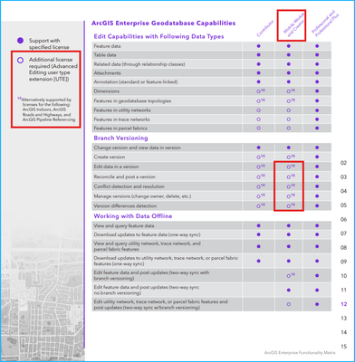

At 11.1 this branch version workflow did not require an additional license and worked with a creator UT, but now an additional license extension for previously licensed capabilities is required.
Are there any other solutions other than purchasing additional licenses, or doing away with branch versioning?

Other than this patch an additional license was listed as needing for this in the current functionality matrix
But happy that it's no longer an issue for simple branch versioning. They do mention in the patch blurb this does not yet allow access for the Web Editor application, and only for the service endpoints themselves, so does work fine for ExB / WebMap editing.
I've applied the patch and can confirm that we can now once again edit branch versioned data with a standard CreatorUT and not needing Advanced Editing extension.
