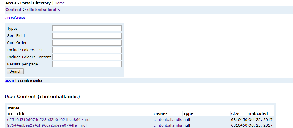

If I search for the item e5516d3106674d528b62b01621bce864 in the contents folder on the Portal server no files are returned. However if I search in the Portal itself through I can find the item. If I click on the item to try an access the item details to delete it nothing is returned.
I've tried going into the rest/sharing directory and into my content. I can see the items I want to list however when I select one to delete and internal server error 500 is returned.
