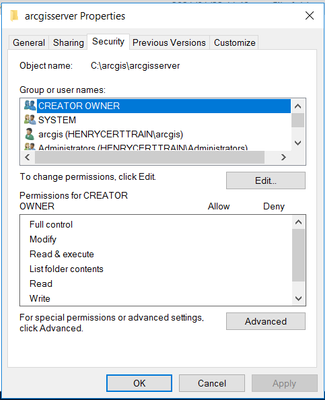

Hi @WenliYang,
First thing I would do is to check if the psychical services are still present
C:\arcgis\arcgisserver\config-store\services
C:\arcgis\arcgisserver\directories\arcgissystem\arcgisinput

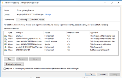

If these folders are still present then probably the folder permission was lost,
Right click the arcgisserver folder go to security then advance and add your service account again also check if you service account is still working correctly.

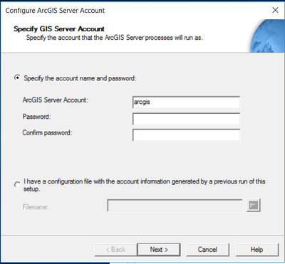

You can also use the Configure ArcGIS Server Account to re-apply the folder permissions
Hope it helps

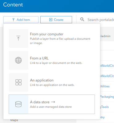

Hi @WenliYang, In 10.8.1 they added new features where a you can add a data source out of portal this is the connection you are seeing in Site -> Data Store.
the connection is managed out of portal that is why the delete function is grayed out .
Hope it helps
Henry
WenliYang
Henry, many thanks for your response @HenryLindemann
All the directories are present and access permissions are all fine (arcgisserver, arcgisportal, arcgisdatastore, arcgisimageserverfiles, as well as their subfolders).

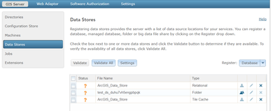

There is a folder named with random appended to the characters (e.g., dataFolder_ds_mdlhgrzykfig1fd6) in the Site->Data Store. It cannot be edited or deleted (edit/delete check boxes greyed out).   As I mentioned that the issue occurred shortly after a publishing process during which the publish tool tried to copy data. But the data folder was previously registered and should not be copied (correct boxes checked before hit "Publish"). I tried to cancel the publishing process and it just hung there so I simply closed the Pro. Is it possible that the failed publishing process has anything to do with the problem?
On start up is the server loops trough all the services starting them and then stopping them when it is done. I think this process is being interrupted probably by the aborted publishing that causes some sort of problem.
It might also be the .rlock files, I have seen if there crash and they did not get removed the system will not start correctly.
Just make a backup of the system and then stop the server and delete all the .rlock files.
Is your ArcSOC spinning up ? this is the actual services for non-hosted services.

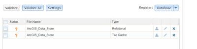

Then you can remove the datastore links -this just removes the link to the datastore it does not remove any data- to just check if the problem is stemming from ArcGIS for Data Store.
and re-register the connections afterword's
WenliYang

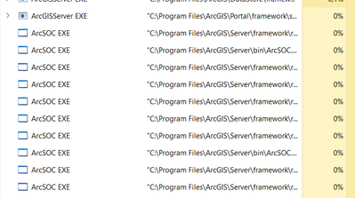

Thanks again, Henry @HenryLindemann, for the tips. We were able to remove the datastore items based on your advise. However, the service manager still shows nothing (i.e., not service) although we got rid of all .rlock files and restarted the server ( stop datastore service, stop arcgis service, delete all rlock files in all folders, start service, start datastore service). There was no ArcSOC process present. We encountered got problem of numerous hung ArcSOC processes before but now we got a no service problem.

Hi @WenliYang, so the main problem is the ArcSOC's not starting up this is why all the services are missing in ArcGIS Server.
If you have antivirus on the server you can go trough the logs and make sure the antivirus is not blocking ArcGIS paths stuff like pkill.exe for a test you can also stop the antivirus and see if ArcGIS server is starting up.
Something might have corrupted in the back-end so you can  uninstall and then re-install the ArcGIS Server +- 1 hr effort, the uninstall will remove most of the application files but not the content and hopefully also the component that is causing the problem and if you uninstall and re-install to the same directory then you will not have data loss but please make a backup before hand.
On the startup process if you open task manager does the ArcSoc spin up and then spin down ?
If you set the logging to debug do you see any information in the logs? It might just be that failed service that is crashing out the system.

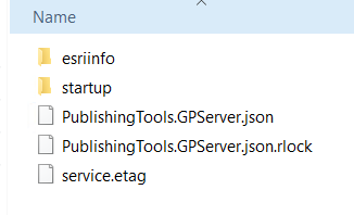

It turns out that we didn't fully get your first tip about the arcgisserver folders. The two subfolders were there and the access permissions were appropriate. But the subfolders under the services were gone with only the files left, which causes the services missing. A customer support engineer helped going through all the steps and checked all the folders/files and found the missing subfolders.

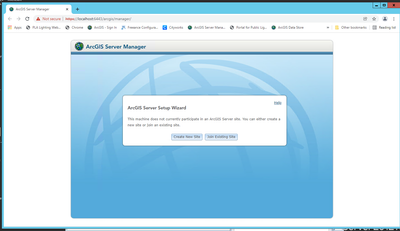

Hi Everyone,

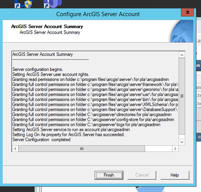

I'm here for the same reason- our services have disappeared and I cannot seem to bring them back. Our logs, config, and directories are all present and I believe the sub folders have everything necessary in them.
The configuration succeeds- but I am still directed to the Server Set Up Wizard.
meaning that has done nothing, I restart services, etc. I am at my wits end here. Any ideas?
Kimme
