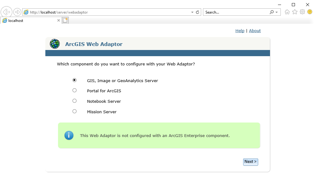

When I tried to configure the web adaptor using the web interface, and click to configure a GIS server:
the browser is directed to https://webadaptorhost/server/webadaptor/server:

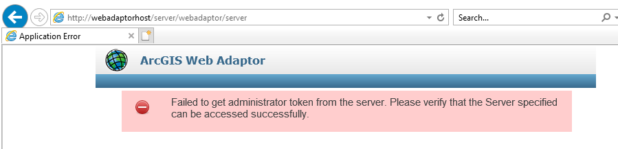

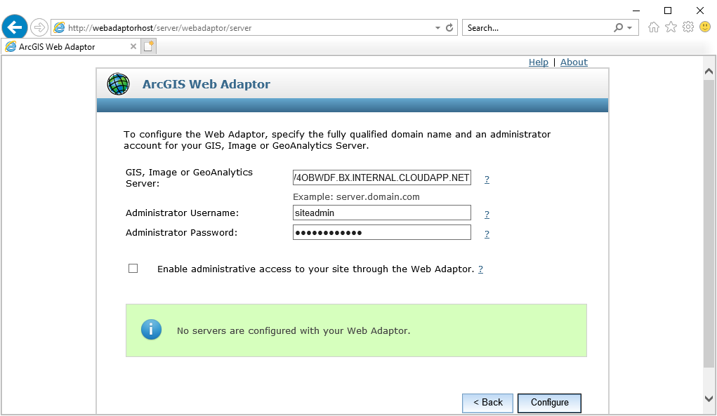

If I manually change it to use http, I get to the configuration page. When I try to configure the web adaptor
I get the following error message:

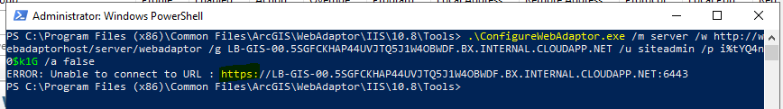

If I try to configure the web adaptor using the ConfigureWebAdaptor utility, it looks like it's trying to force HTTPS
Port 6080 is open on the Server machine.
