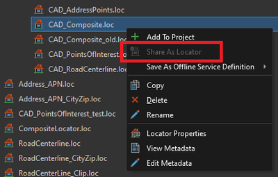

I tried sharing the locator directly to AGOL, but ArcGIS Pro will not let me because its greyed out (see below screenshot). Are you able to do this? It is not greyed out when signed into enterprise.

Are you logged into AGOL and what are your permission levels?
Amanda Bishop, GISP
MichaelBouvet
Yes I am logged in as an administrator.
ABishop
MVP Alum
What level licensing do you have in ArcGIS Pro?
Amanda Bishop, GISP
ABishop
MVP Alum
My apologies @MichaelBouvet
According to this information online, you can publish it using your ArcGIS Enterprise account then share it for use by ArcGIS Online users.
See information here:  https://pro.arcgis.com/en/pro-app/latest/help/data/geocoding/share-a-locator.htm
Amanda Bishop, GISP
Tim_McGinnes
Just to clarify Amanda's answer a bit - you cannot host a locator service on AGOL. It has to be published to your ArcGIS Enterprise. What you can then do is take your Enterprise locator service and set it up as a utility service in AGOL. That way web app users could use your locator instead of the World Geocoding Service. Unfortunately that does mean the Enterprise locator service would have to be internet accessible.
MichaelBouvet
Thank you so much for this clarification! This is what I feared 😕
Our firewall will not permit incoming traffic, so a utility service that references the locator in server will unfortunately not work 😕
