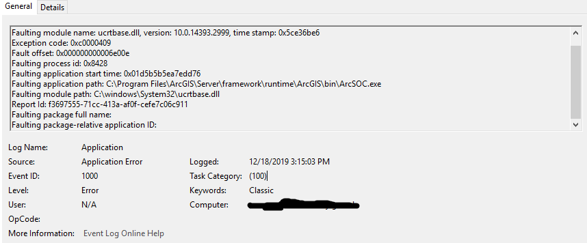

I found in n Windows  Logs>Application:
Faulting application name: ArcSOC.exe, version: 12.4.0.19608, time stamp: 0x5ce60b9f
Faulting module name: ucrtbase.dll, version: 10.0.14393.2999, time stamp: 0x5ce36be6
Exception code: 0xc0000409
Fault offset: 0x000000000006e00e
Faulting process id: 0x8428
Faulting application start time: 0x01d5b5b5ea7edd76
Faulting application path: C:\Program Files\ArcGIS\Server\framework\runtime\ArcGIS\bin\ArcSOC.exe
Faulting module path: C:\windows\System32\ucrtbase.dll
Report Id: f3697555-71cc-413a-af0f-cefe7c06c911
Faulting package full name:
Faulting package-relative application ID:
