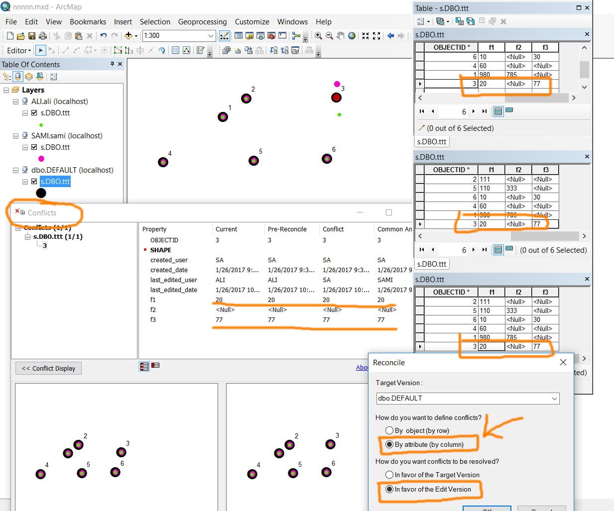

For example, if a feature class is moved in the parent and child versions and the “by attribute” is chosen as conflict definition, then why the ArcGIS detects this spatial change (moving the same feature)? I was assuming that “by attribute” conflict definition considers the change on the same “cell” of the attribute of parent and child as a conflict and has nothing to do with the spatial change. Am I correct?

Hi Jamal - Your first statement is correct. ObjectID 2829 was modified by two users, but modifications occurred to different fields. By Object is a conflict, by attribute is not a conflict.
Your second example has the editors editing different ObjectIDs, so no conflicts of either type would be detected. If however, both editors were to edit the same attribute on the same ObjectID than By Object and By Attribute would both return conflicts.

Hi Jamal - conflicts will always be flagged when geometry changes in multiple versions.

This is very confusing if the change in geometry is still detected with "by attribute" option.
Also, I observed that if only the attributes are changed and the “by object” is selected then the ArcGIS still detects the changes. This adds more confusion on the terms “by attribute” and “by object”. Am I correct?

Hi Jamal - When you are reconciling by attribute, conflict will only arise if the same attribute (or column) are touched by different users. In this sense geometry is simply treated as another attribute. In the case of object (or row) any modification by either user on the same object will be flagged as a conflict.

Can I conclude that all changes (geometry\attribute) will be detected either way and thus no difference between choosing “by object” or “by attribute”?

Not quite, when reconcile by object any change to any row by multiple users will result in a conflict. When reconcile by attribute, the same attribute would need to be edited for a conflict to be raised.

I can conclude than conflict occurs in two cases:
  • Editing the same record on the attribute table. In the first screenshot below:
    • if the “by object” option is selected, then this will be considered as conflict
    • if the “by attribute” is selected, then this will NOT be considered as conflict
  • Editing the same field in the attribute table. in the second screenshot:
    • if the “by object” option is selected, then this will NOT be considered as conflict
    • if the “by attribute” is selected, then this will be considered as conflict
is this right in all cases?
