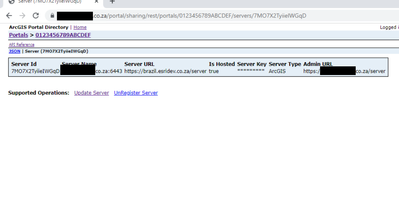

Answer:
https://your_name.co.za/portal/sharing/rest
login
https://your_name.co.za/portal/sharing/rest/portals/0123456789ABCDEF/servers
click on the server id and UnRegister Server
Hope It Helps
Henry

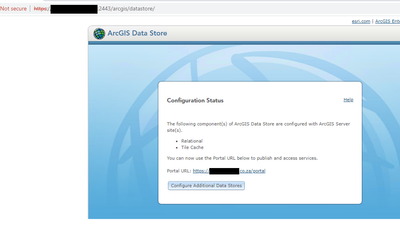

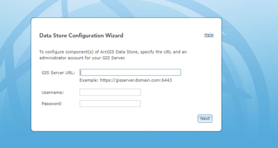

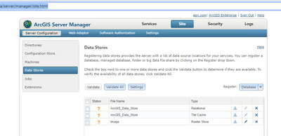

HenryLindemann
Hi @ArranGIS, the datastore is probably still reverencing the old url all you do is re-register it.
Go to https://your_url.co.za/webadaptor_name/manager/site.html then datastore and click on the x for relational and tile cache if present.
Then go to the server that datastore is installed on and reregister the datastores
This is the admin password for ArcGIS server
go to the describe tool when you are done and run it in a administrative command prompt the new URL's should reflect
"C:\Program Files\ArcGIS\DataStore\tools\describedatastore.bat"
or where you installed the datastore app.
Kind Regards
Henry

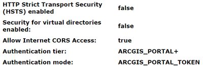

JonathanQuinn
Esri Notable Contributor
If you signed into the Server Admin API and go to security > config, does it show ARCGIS_PORTAL or GIS_SERVER for the Authentication Tier property?
It should show GIS_SERVER. If it shows ARCGIS_PORTAL, go to Update at the bottom and set it to GIS_SERVER.
