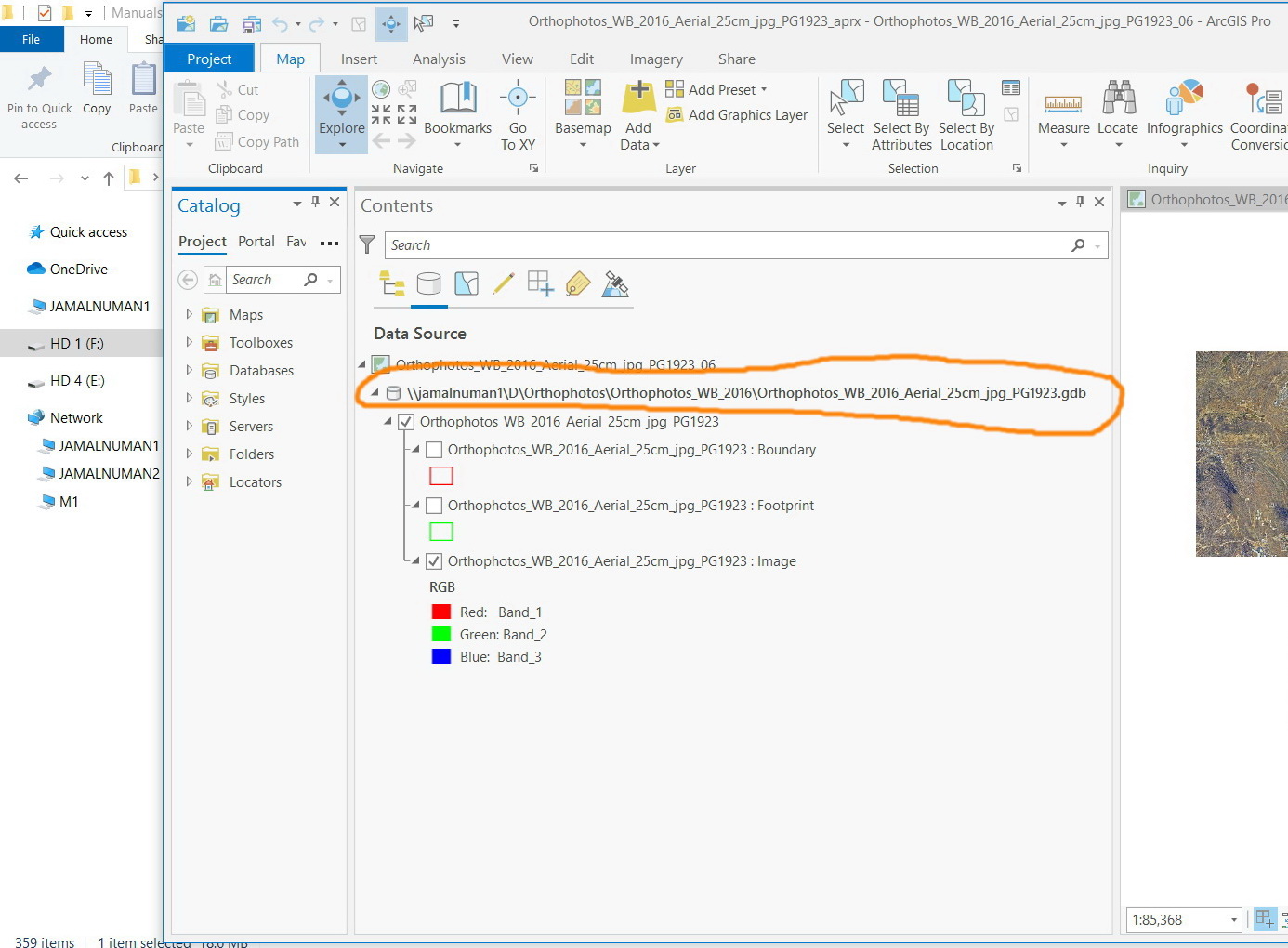

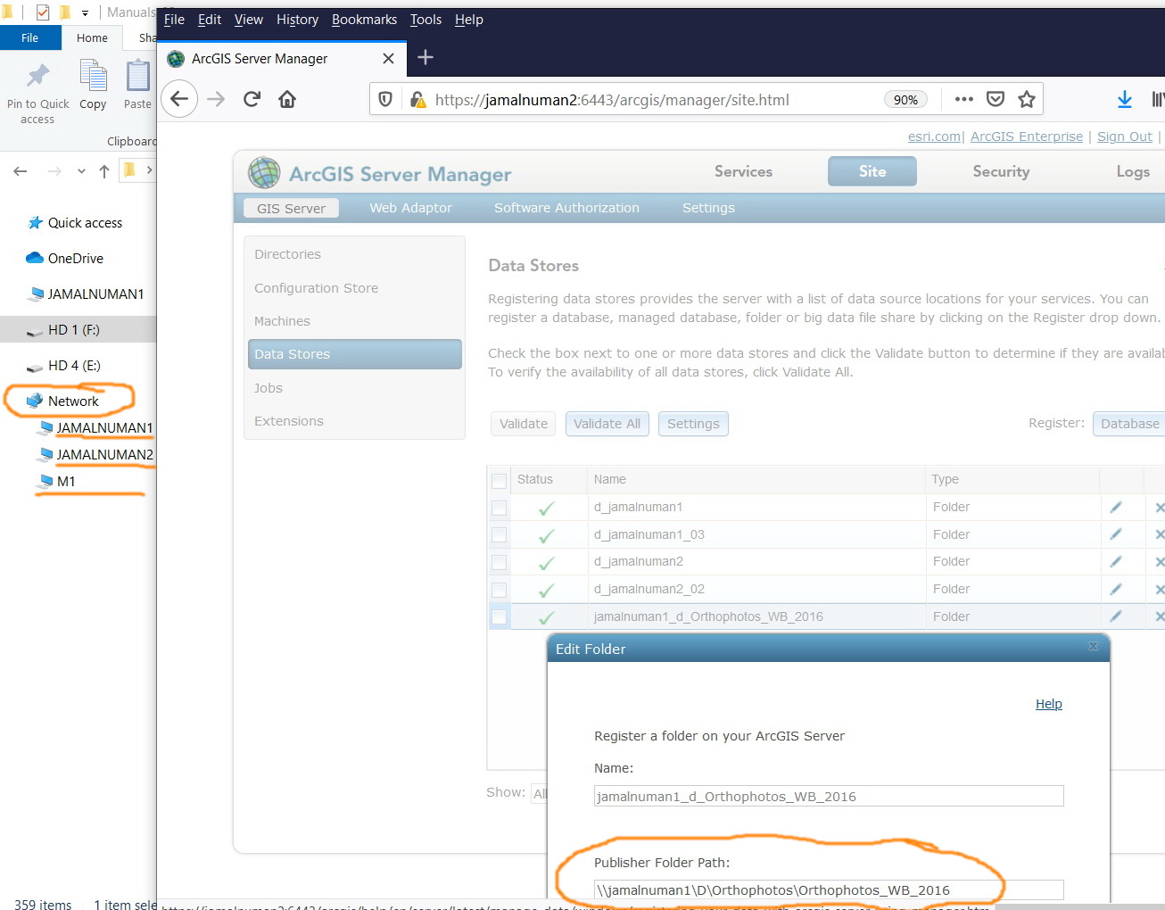

The data needs to be referenced with its UNC path in order to be approachable internally from everywhere
