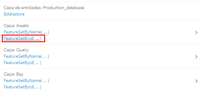

Hi Invenergy GIS User ,
Arcade can work with flat tables and featurelayers.
Did you construct this line manually or did you use the interface to create it, like this:
If the test returns an empty featureset (just field names) you should check is the service is up and working correctly.

Thanks, Xander Bakker‌!
I used the interface as in your screenshot.
I gave the records in the flat table a fake lat/long and republished so it became a spatial featureset.  Then the FeatureSetByName and ByID work fine.
You said Arcade works with flat tables, which I see is true, but that particular function just gives me empty featuresets.
