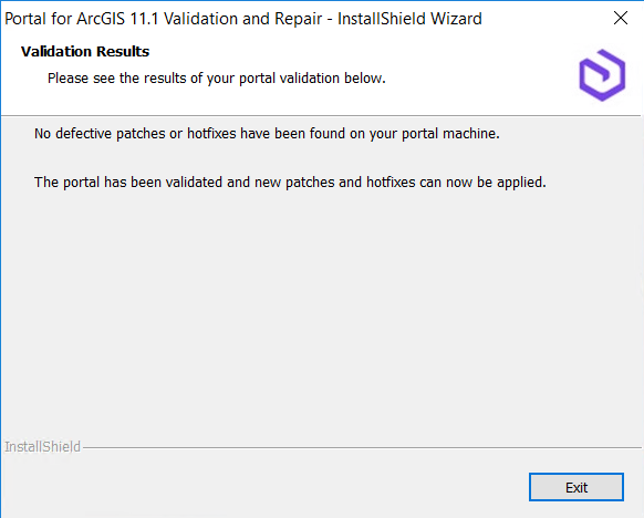

I installed the Portal for ArcGIS Enterprise Sites 2023 Security Patch package on the ArcGIS Enterprise 11.1 Portal server. I followed the instructions exactly and first ran The Portal for ArcGIS Validation and Repair program, which fixed the faulty program.
