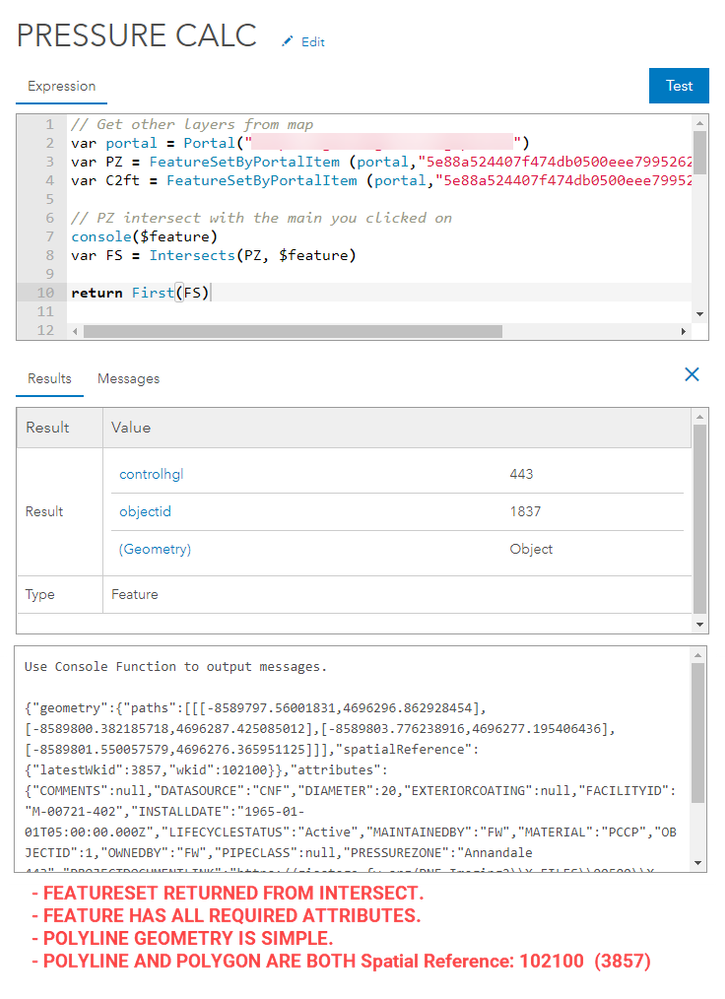

ahargreaves_FW
@jcarlson  can you tell me why the below works for one polyline layer in my map:
// Get other layers from map
var portal = Portal("https://gxxxxe.xxxx.org/portal")
var PZ = FeatureSetByPortalItem (portal,"5xxxxxxxa",1, ['controlhgl'],true);
// PZ intersect with the main you clicked on
var hgl = First(Intersects(PZ, $feature))
return hgl.controlhgl
But the identical code will not work for another polyline layer within the same map giving the below error:
Execution Error:Runtime Error: Cannot call member method on null. controlhgl
For some reason the second polyline appears to never intersect with the same polygon as the first polyline, despite that clearly not being the case.

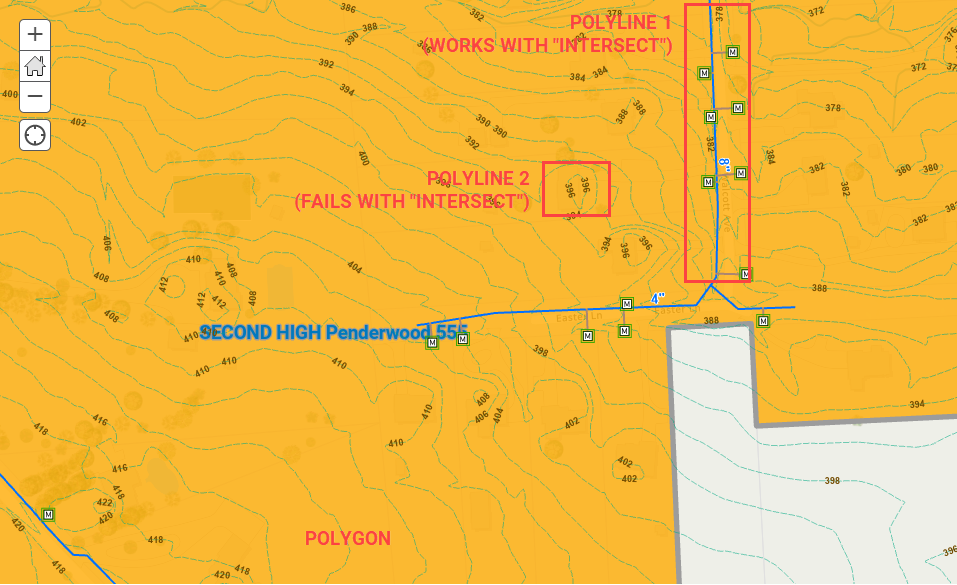

ahargreaves_FW
@jcarlson it's a polyline to polygon intersection. And I double checked to ensure both lines are inside of the same polygon - they are. For the Polyline that works I see that my intersect returns a featureset, and then a feature within that:
For the polyline that fails to register as intersecting with the polygon I get no such featureset, and therefore no feature to grab my attributes from:
This polyline has the same spatial ref as the first, but does have significantly more complex geometry. But, once again, the two polyline featureclasses do definitely intersect the polygon featureclass spatially:
