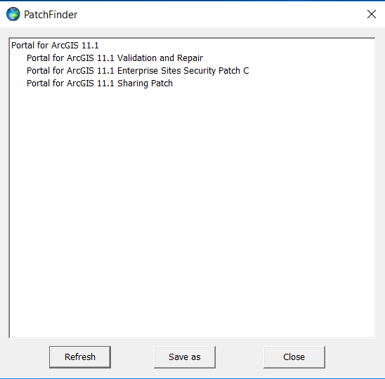

Finally, I ran the PatchFinder.exe Utility program to make sure that version C was installed on the machine. At this point, it is important to restart the Portal server.
After that, I carefully tested in the ArcGIS Enterprise environment that everything works as it should in the Portal's browser applications, Field Maps, and ArcGIS Pro. Everything seems to work perfectly. It is good to reserve 3-4 hours of working time for software patch installations per server.
