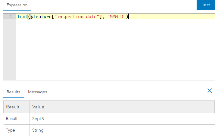

After upgrading to Enterprise 11.3, we noticed some Arcade issue. For example, an Arcade expression
Text($feature["inspection_date"], "MMM D")
will give Sept 9 instead of Sep 9. It is supposed to be three letters abbrev.
I guess in the source code, it is getting str [0:3] rather than [0:2]? As a workaround, we changed it to the one below.
Left(Text($feature["inspection_date"], "MMM"),3)+" "+Text($feature["inspection_date"], "D")
