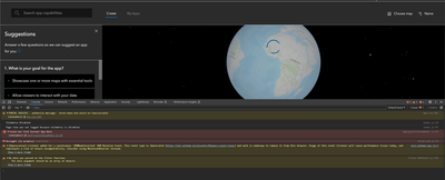

Here is the dev console from Chrome:
The Chrome console error says it can't find the Instant App Data from here:
 webpack://instant-app-landing/src/app/data/AppTypeInfo/AppTypeInfoViewModel.ts
DavidColey
MVP Frequent Contributor
the console log show lots of 'failed to load resource' . . .

DavidColey
No problem.  If you look at my earlier reply with the dev console image, you will see that the Chrome console error says it can't find the Instant App Data from here:
I have tried in Edge, both in-private and standard, and in Chrome both incognito and standard.
I've got a case in with esri, but yes there are lots of 404s, mostly with Calcite components:
..../apps/instant/node_modules/@esri/calcite-components/dist/calcite/p-f4be18ed.js
