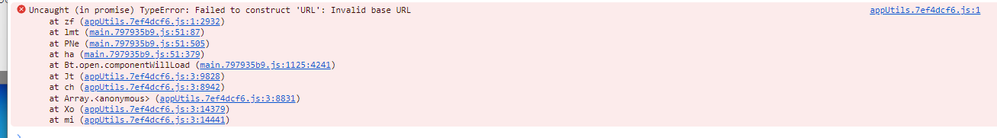

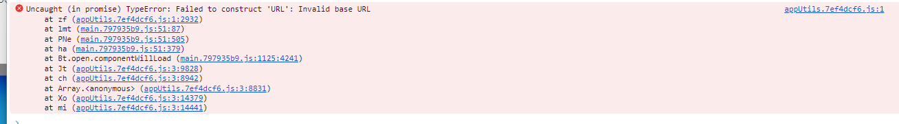

I am trying to use Instant Apps for the first time and I am getting this error in my Chrome DevTools console when I first create the app and if I click Configure on the instant app item page. The web page remains blank white.

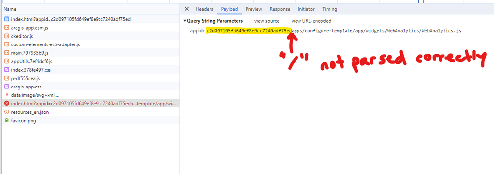

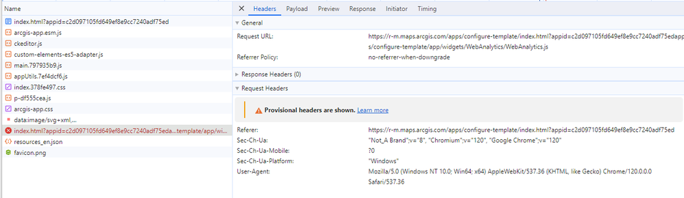

Some more context of the network data
It seems that the appid query string parameters is malformed, missing the "/" delimiter, which causes the Request URL to be incorrect.
