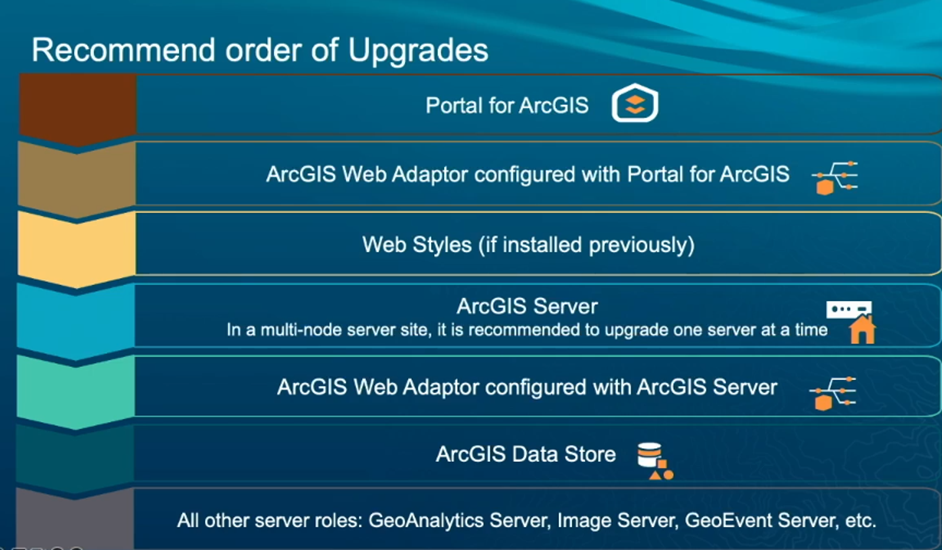

  • The plan is to manually upgrad each component following the official doc and recommended upgrade order, e.g.,

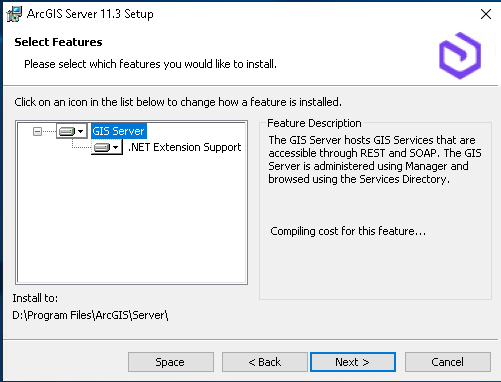

  • After Portal was successfully upgraded, we continued to upgrade the hosting ArcGIS Sever by running the Windows installation file, e.g.
  • The above ArcGIS Server 11.3 installation took about 1 hour to complete. There were no errors, and the installation was successful.

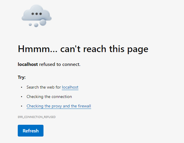

After the above steps, a browser session was triggered, trying to connect to the ArcGIS Server Manager website to complete the upgrade, but it couldn’t be loaded. Tried https://localhost:6443/arcgis/manager/ or https://servername.xyzxy.local:6443/arcgis/manager, and both showed the same error in browser like below. It looks like the ArcGIS Server's Tomcat server is down.

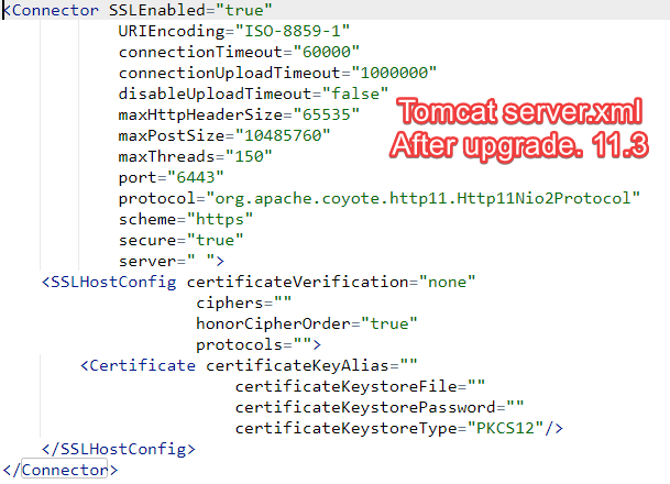

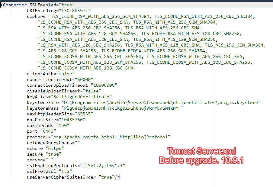

3. Tomcat server.xml seems corrupted after the upgrade. For the last part of the file, the <Connector> section here is before VS after the upgrade.

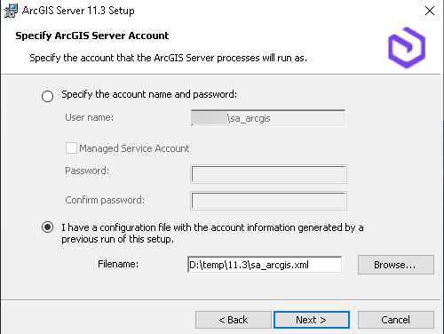

1. During the installation of the ArcGIS Server, a domain service account was nominated to run it. But the Windows Service shows it is running under the Local System after installation. Is this expected? The 10.9.1 ArcGIS Server Windows service is running under the specified domain account.

Qusetion: During the installation of the ArcGIS Server, a domain service account was nominated to run it. But the Windows Service shows it runs under the Local System after installation. Is this expected? The 10.9.1 ArcGIS Server Windows service is running under the specified domain account.
A: As David mentioned, the Windows service for the ArcGIS Server should run under the nominated service account during the installation. A silently failing back to the Local System can be a permission issue. Make sure to run the installation file as an administrator, and the nominated service account should have full control over target ArcGIS-related file folders, e.g., C:\arcgisserver, and C:\Program FilesArcGIS (these folders can be different if using non-default configuration).

Hello Hua - I'm not sure that an underscore in a domain service account name is allowed and that may be why the 'Log On As' from the services window is showing as running under Local System.
- or the directory permissions for the domain account are such that the domain account could not fully access all of Server's directories
- or it did not have full write permissions to create any new directories that 11.3 may need.
If the domain account is set up properly, the ArcGIS Server windows process should be showing that it is running from the account:  e.g. domain\arcgisserviceaccount, not Local System or Local Service.
