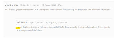

@Scott_TansleyI have read that documentation.
Add Viewer credentials to a workspace
More here:
https://www.esri.com/arcgis-blog/products/arcgis-enterprise/sharing-collaboration/whats-new-in-arcgi...
