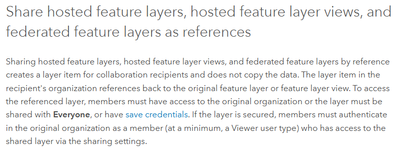

A quick check on the ESR workflow and I found this section on Copy vs Reference:
https://doc.arcgis.com/en/arcgis-online/administer/create-a-collaboration.htm
Choose one of the following to specify how hosted feature layers will be sent to the collaboration workspace:
  • ReferencesCollaboration participants will receive live access to feature layers. If the item is secured (not shared with everyone), users must sign in to the origin environment to access the item.
  • Copies—Collaboration participants will receive a copy of the feature layer, and updates from the origin will be synchronized at a scheduled interval defined by the guest.
    Note:
    If you choose this option, the collaboration guest must set a sync interval in the collaboration workspace, and sync must be enabled on each item in the collaboration. A copy of the feature layer and its data will be extracted and published as an item in each recipient's environment. Once the item has been created, subsequent synchronizations will only sync updates of that item.
Am I missing something here? Or is this red text essentially telling me that Guests can't access Host content as References unless they have login credentials for the Host organisation or if the layer has Public access enabled? If so, what on earth is the point in Distributed Collaborations??
