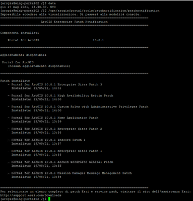

JonathanQuinn
Esri Notable Contributor
You'll need to install the HA Rejoin patch, not the Sites 3 patch. The Sites 3 patch does not have the fix in it. Once you install the HA Rejoin patch, you can try the shortname workflow.
https://support.esri.com/en/Products/Enterprise/portal-for-arcgis/portal-for-arcgis/10-8-1#downloads...
Oiligriv
Hi Jonathan I did the environment update and immediately after running all patches.
Since then the Backup hasn't worked anymore.
I haven't changed hostnames or configuration.
Before the upgrade backups in 10.8.0 were successful.

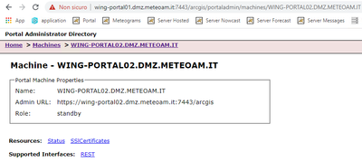

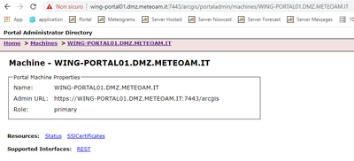

EricAnderson_DHS
@Oiligriv ,
Go to https://portal.domain:7443/arcgis/portaladmin/machines/<machine  name>, what is listed as the Admin URL? If it's  https://portal.domain:7443/arcgis/portaladmin,  then that's the issue (should not have "/portaladmin", should end in just "/arcgis") and follow the instructions in this comment to fix it:
https://community.esri.com/t5/arcgis-enterprise-portal/webgisdr-backup-fails-with-quot-failed-to-gen...
Oiligriv
Hi EricA
thanks for your intervention
the portal correctly reports the admin url https: // fqdn: 7443 / arcgis
The portal is in HA, also the second node correctly reports the admin url
