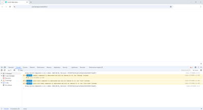

Hi everbody,
I am using ArcGIS Enterprise 11.3, the web editor does not open, I could not find a source about the reason. he page does not respond, it remains a white page.
@CraigGillgrass
[modal] component is deprecated and will be removed in v4. Use "dialog" instead.
