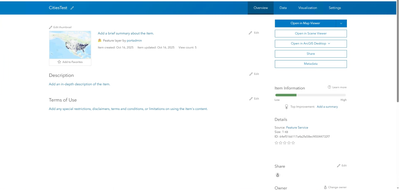

My hosted feature services are migrating no problem using the service definition files. However, trying to publish referenced feature services from Pro is resulting in blank feature layers. The logs in Server Manager and in Pro are not indicating that there are any issues with the publishing itself. I'm wondering whether I made some mistake with configuring my 11.5 environment. I tried all the following yesterday with Tech Support.

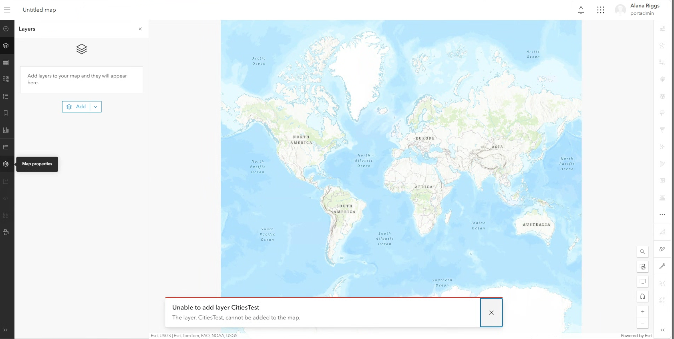

  • We discussed that the referenced feature services in Portal for ArcGIS are not rendering in Map Viewer

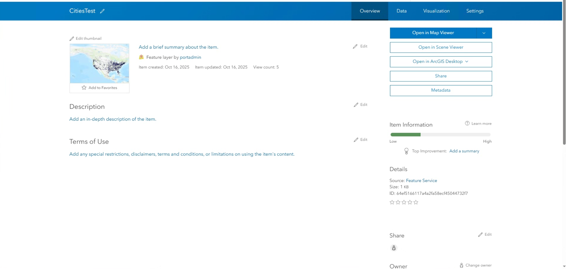

  • The same data, when published as a hosted feature service from the same database from ArcGIS Pro, it does renders as expected

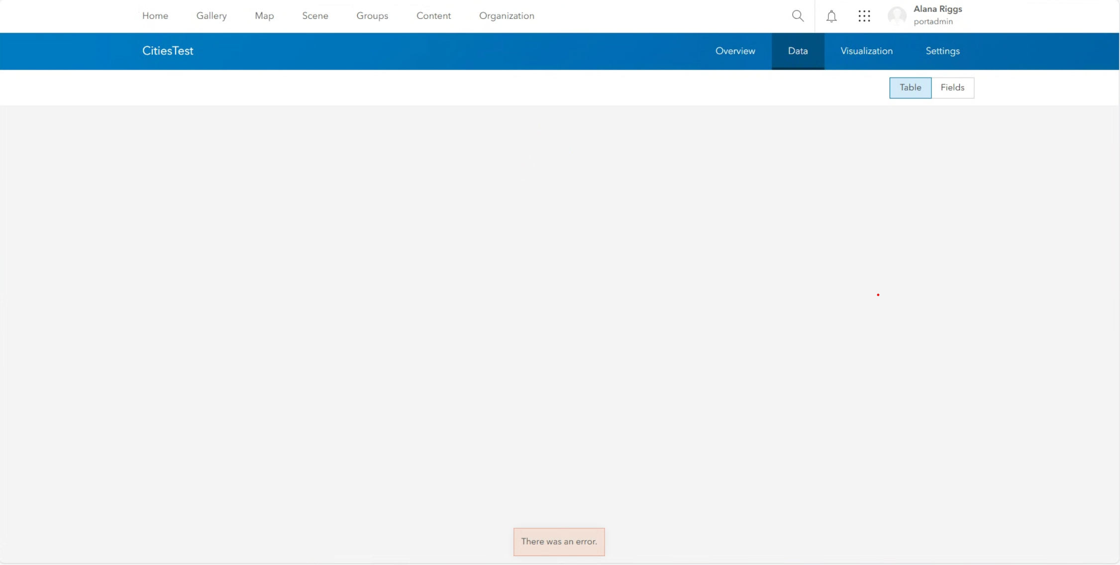

  • Clicking on the service URL directly from the item's overview page in Portal for ArcGIS does not load

  • It could also be observed that the feature layers are not listed under the layers section in the Overpage of the item in Portal for ArcGIS

  • We did observe in DevTools, URL https://gis.pmlp.com/portal/sharing/proxy?https://gis-s.pmlp.com/server/rest/service/CitiesTest/Feat...  has failed with 500 Internal Server Error
