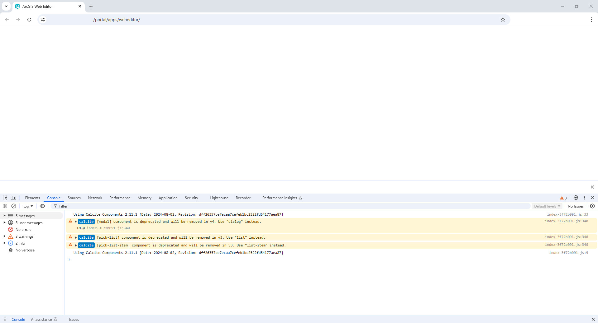

Hi everbody,
I am using ArcGIS Enterprise 11.3, the web editor does not open, I could not find a source about the reason. he page does not respond, it remains a white page.
@CraigGillgrass
[modal] component is deprecated and will be removed in v4. Use "dialog" instead.

@JohnGoat Have you ever been able to open the Web Editor since it was installed? Or did this just start to happen?
The warnings you see in the console are not the issue.
