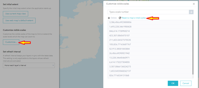

@HalilSiddique if you reset the scales in your app the map will display

this is the url we use: https://api.os.uk/maps/raster/v1/wmts?key=
so its the map service rather than the vector service
