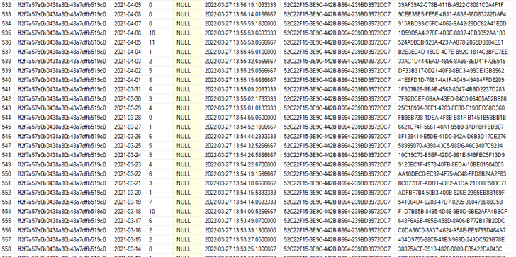

John_Spence
You could adjust the code base of this tool AGOL-MetaData Snagger to lookup the view count daily and subtract from the previous day, and store it. You would get something that looked like this...
Then you could take that date and generate up metrics that start looking like this....
Which will turn into dashboards, etc.
