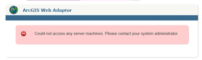

updating from 10.9 to 10.9.1 the webadaptor registers on the server but not immediately after when I check the registration, the web page says that no server is accessible.

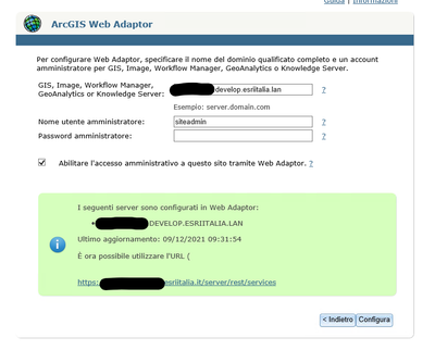

Oiligriv
my installation is with only one ArcGIS Server (Hosted)
the upgrade went great for all components
WebAdaptor (Portal) ok
ArcGIS Portal (ok)
WebAdaptor (Server) ko (impossibile registration)
ArcGIS Server (ok)

after re-running the restore of the Portal
- Uninstalled any ArcGIS Enterprise add-ons
- Upgraded all ArcGIS Enterprise Portal + ArcGIS Server + Datastore
- (I know this is wrong) Login test via WebAdaptor 10.9 everything ok
-Upgrade WebAdaptor Portal 10.9 to 10.9.1 ok
-Upgrade WebAdaptor Server 10.9 to 10.9.1 registration is successful, but the server is not accessible.
