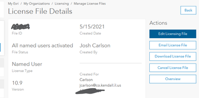

I went to create a new license file for our beta environment by following the instructions on this page: https://enterprise.arcgis.com/en/portal/10.7/administer/windows/obtain-portal-license.htm
But I was unable to create the file because it said I had 0 available Creator license types (out of 100), and the option to specify how many Creators I wanted was grayed out. My understanding from the documentation is that I should be able to draw from my currently authorized pool of licenses and just overwrite the number that is currently authorized. I have the full 100 users "claimed", but I thought when I went to generate the license file, I could just say that I still wanted those users plus whatever I wanted to add.
The option to generate a new license file is available when choosing a different version of Portal. However, I am not upgrading to 10.8.1, I am just trying to provision more viewer types for 10.7.1 (our currently version).
jcarlson
MVP Esteemed Contributor
It's doing that because it thinks you're generating an additional license to go alongside the current one, which is currently claiming all those users.
Open the current license file and go to Edit it.
This will allow you to carry the user types forward into the new license, replacing the old one rather than supplementing it.

MaryGraceMcClellan
Thanks! By any chance, do you know if editing the license file (which, according to My Esri will "cancel" our current license file) will make any changes to the environment before I import the new license?
jcarlson
It shouldn't. At least, I've never had any users notice anything between generating the new file and making the required updates.

Hey There, Urgent help needed to mitigate the downtime I have caused. I generated a license file for version 10.9.1 and yet the installers available were for v10.9. after running the installation of Portal and attempting to authorise I got the invalid license file error;
I am attempting to edit the License file to v10.9 so that I can complete the upgrade from 10.8 but unfortunately the creator users are grayed out. Sadly I'm stuck as I cant proceed with creating the License file with 0 creators?
FionaRenton1
I had to figure this out a few weeks ago.
In order to regenerate the Portal license for 10.9 you have to cancel the license file for 10.9.1In Authorizations, click on License management on the left side and select the license for 10.9.1 and choose "Cancel license file"
Wait a few minutes and then reauthorize the licenses for 10.9
MarkShibuta
Thanks Fiona,  this worked!. Thanks again.
