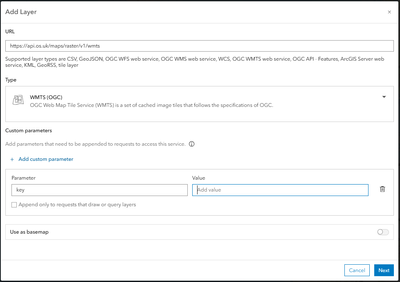

Hi @SamJakson I'm sorry you're still having trouble with the OS Maps API in Map Viewer. I've just tested this in ArcGIS Online Map Viewer myself without issue so I'm hopeful it should be possible to get it working for you with a bit of troubleshooting.
  • Assuming you're using ArcGIS Online, please make sure that you don't have the OS domain added to your list of Trusted Servers (Organization > Security > Trusted servers). This can cause your browser to block the CORS requests to the service.
  • When adding the layer in Map Viewer be sure to use the Custom parameters functionality to specify your API key
I hope this helps!
