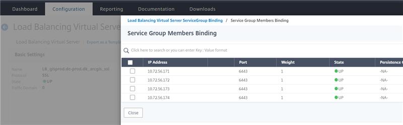

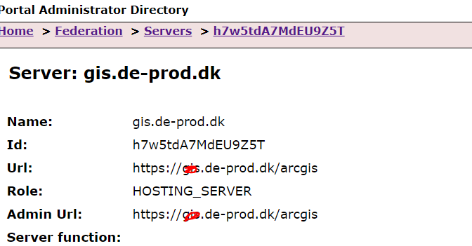

2) privateportalurl is only meant for internal administrative purpose by esri software components. we can't use this url for our purpose e.g if I redirect main portal lb url to some maintenance html page so whosoever accessing this portal will be route to maintenance page and if we can use this privateportalurl to do all our maintenance work is not possible? Do you have any better suggestion here other than suggesting information banner and read-only mode because information banner only appears if user is accessing webapps or webmaps using main portal url but it doesn't work if webapp url is bookmarked in browser and access directly. also , information banner doesn't appear on top of operations dashboard either.
3) Is It ok to use federated highly available ArcGIS server serviceurl and administration url same like shown below
redirecting to ( we are not using web adaptor for our hosting highly available layer)
