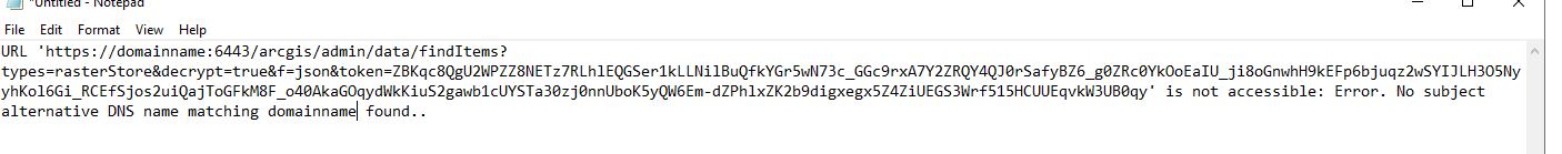

When I go to the logs, this is the error (note: my domain name is removed in the screen shot below)
It looks like its not finding the raster store, which I'm fairly certain I didn't install.
I've done a repair on the portal, server, and datastore.  My federated server in portal comes back as "all systems operational", in Server Manager, my ArcGIS_Data_Store validates as well.
So, my question is, can I ignore this, or do you know of a way to fix it?

I found the following article and it seems that the internal certificate is the issue:
You can probably ignore it, but it is best practice to use a CA signed certificate in your deployments.
Here is the documentation on how to import a CA signed cert into Portal and Server Admin endpoints:
Note that the server/domain certificate that you use for Portal and Server should be issued to the hosting machine's FQDN and not the DNS alias.

My issue was that I didn't fully import the certificate into server - I got it uploaded, but failed to configure it.  The last bullet point (Configuring https using an existing...) gave instructions on how to configure it. Once I got it configured, I restarted the server for good measure, and than tried again.
