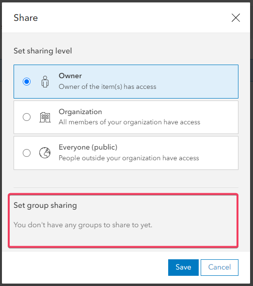

Hi there,
We have just upgraded from 10.9.1 --> 11.1.
There is a builtin portal user account which has a large amount of content and owns a large number of groups ~163. What we are seeing is post upgrade when we try to share from an item we see this:
even though this user does own and belong to multiple groups.

MarleyGeddes
@FraserHand - I believe the issue you are seeing is the same as that reported here: https://community.esri.com/t5/arcgis-enterprise-portal-questions/portal-for-arcgis-11-1-can-no-longe...
If the member owns or manages more then 30 viewOnly groups, which are groups that are configured to only allow the group owner or managers to contrubte to, then the query to fetch groups will fail.
Esri support has a defect for this issue, BUG-000158232, and the development team is looking into this. If you have Esri Support, then I encourage you to request to be added to this defect and to share your specific workflow / scenario with the support team.
