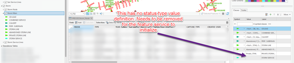

So in my case, I had a faulty symbology definition applied to the missing layer in my feature service. See below. I had a symbology class with no associated value. Fine for a map service, not OK for a feature service.
The drawbacks of reusing / importing symbology across projects has been felt and noted haha.
featureserviceissue.pngSomething that helped trace the cause was checking the server logs for the service and seeing a severe message: "Initialization of Layer: Storm Main failed."
