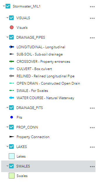

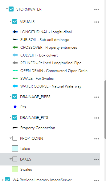

Thank you for the response. I have screenshot below the problem. On the left is how it should be., On the right is how the web map is after I overwrite a MIL. The point and line features end up in the wrong layers.
I checked my project and the order within the layer has not been changed.
