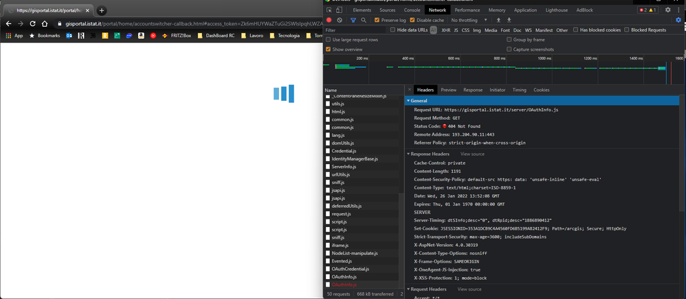

some idea?
When I log in, the portal seems to stay in the Loop.
if I log into portaladmin everything works fine.

Oiligriv
even clearing the cache the problem persists

I keep finding similar issues, but I cannot login with admin account to ArcGIS Portal. All other issues concern some ArcGIS apps.
What is weird, this behavior only happens on internet. When I attempt to login on intranet where the virtual machines are, I can log in normally.
