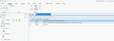

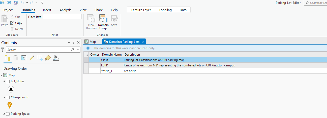

Hello. I have a question about why I am unable to edit the domain of a hosted feature layer in ArcGIS Pro after I have published it to the portal. I know the domains can be edited from the item page on the portal after publishing, but I'm curious why the domains would be "read-only" in Pro after publishing the layer to the portal. Any information on this would be helpful.

See message at the top of the domains page in Pro:
