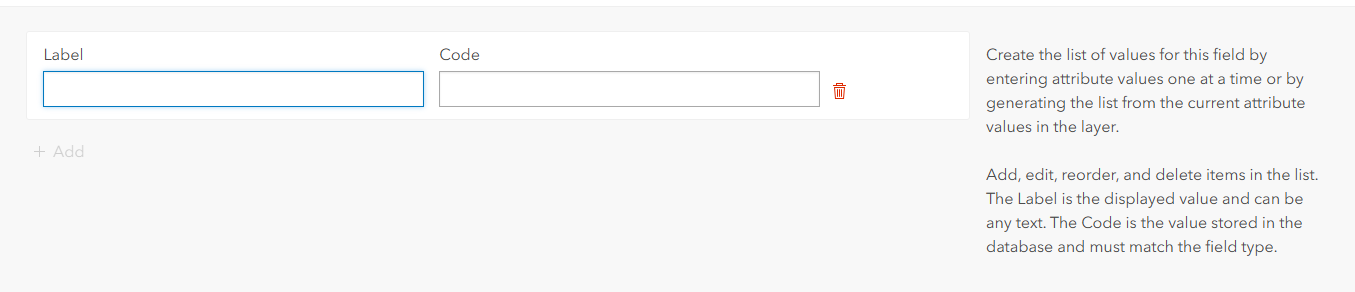

I have a field I'd like to create a drop-down list for. The drop-down contain 300 options. I'm not going to enter 300 options manually.
Is there a way to upload a list in Portal? Similar to running the Table to Domain geoprocessing tool in ArcPro?

I really wish ESRI would have this option of uploading a csv file under "Data" and "Field" window, but here is the solution/workaround:
  1. Open the hosted feature layer in ArcGIS Field Maps desktop version and create a form.
  2. Add the layer that needed a list.
  3. Select "Combo" under Input Type.
  4. Click "Manage List".
  5. At the bottom, click "select from your device" and upload a csv.
  6. Click Done and save your form.
The combo list is now saved in your hosted features.
